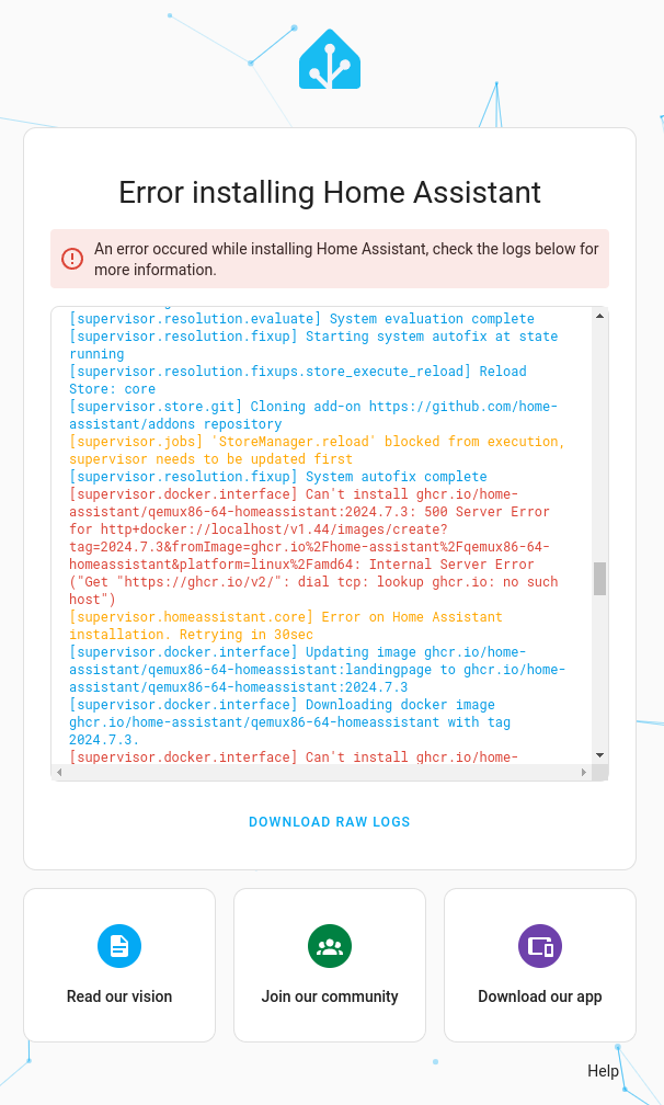

“Error installing Home Assistant”
Symptom: During onboarding, there is an “Error installing Home Assistant”
You are in the onboarding procedure, but you get the message Error installing Home Assistant.
Error installing Home Assistant during onboarding
Resolution
  1. Make sure your network has internet access.
    • During first startup, time will be synchronized. Ensure NTP is allowed in your network.
    • During first startup, Home Assistant completes the installation. It needs access to the following URLs:
      • version.home-assistant.io: to fetch new version information.
      • github.com: to update metadata of the add-on store.
      • ghcr.io: the GitHub container registry to fetch new Home Assistant updates.
  2. After changing your network environment, wait a few minutes. Home Assistant will try to reconnect.
  3. Reach out to our community for help.
