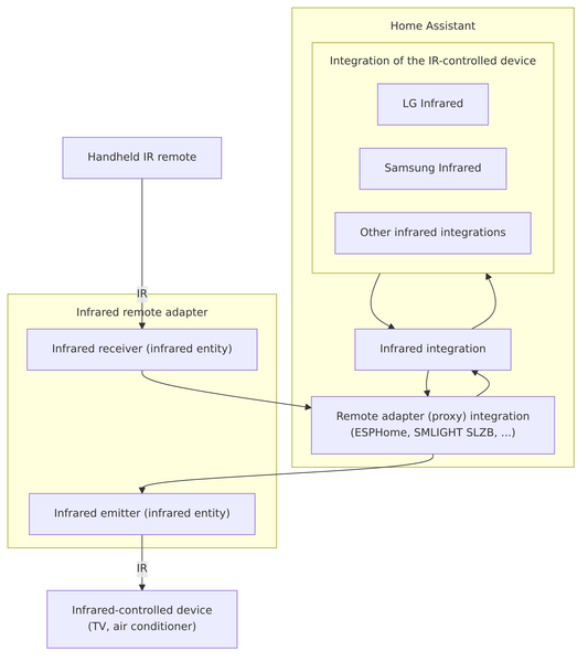

The Infrared integrationIntegrations connect and integrate Home Assistant with your devices, services, and more. [Learn more] allows you to use Home Assistant to send commands to infrared-controlled devices, or to receive signals from infrared remotes. The integration acts as an abstraction layer between the following components:
- An infrared remote adapter (proxy) hardware
- An integration that provides infrared entities by integrating an infrared remote adapter (such as ESPHome or SMLIGHT SLZB)
- Device-specific integrations (such as LG Infrared or Samsung Infrared)
You can control infrared-controlled devices from Home Assistant without touching the handheld remote control. You can also send signals from the handheld remote control to Home Assistant. The chart illustrates how this is possible via the integrations.
How the Infrared integration connects device integrations to an infrared remote adapter through a remote adapter integration.
