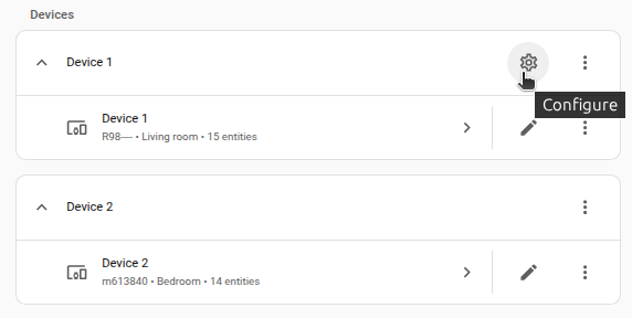

To define options for ONVIF, follow these steps:
In Home Assistant, go to Settings > Devices & services.
If multiple instances of ONVIF are configured, choose the instance you want to configure.
On the card, select the cogwheel
. - If the card does not have a cogwheel, the integration does not support options for this device.
Edit the options, then select Submit to save the changes.
