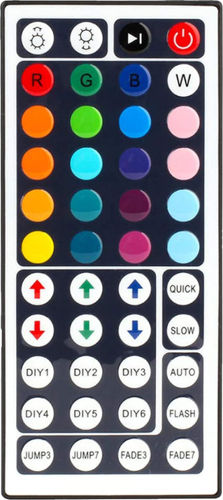

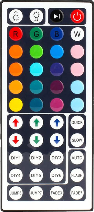

44-key remote
44-key remote

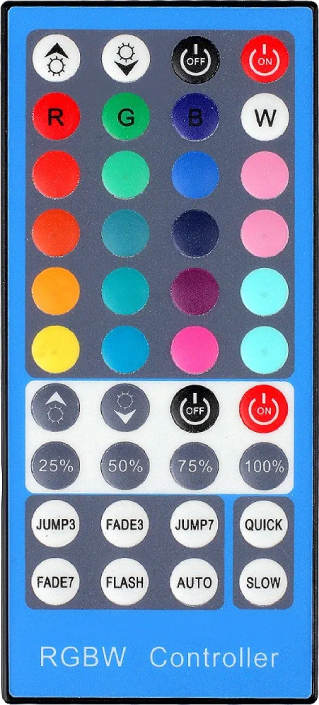

40-key remote
40-key remote

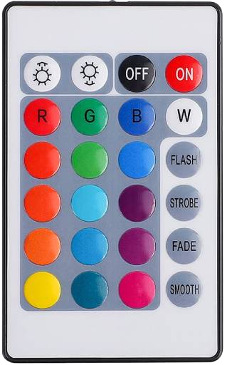

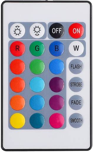

24-key remote
24-key remote

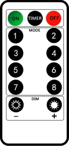

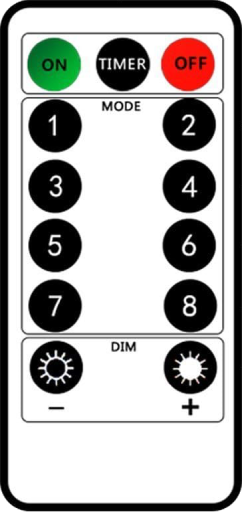

13-key remote
13-key remote

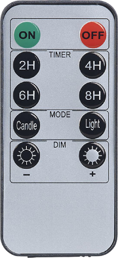

10-key remote
10-key remote

  • Timer
    • Description: Enables the timer, turning the light on for 6 hours and off for 18 hours in a repeating 24-hour cycle.
    • Available for: 13-key remote
  • Timer 2h
    • Description: Enables the timer, turning the light on for 2 hours and off for 22 hours in a repeating 24-hour cycle.
    • Available for: 10-key remote
  • Timer 4h
    • Description: Enables the timer, turning the light on for 4 hours and off for 20 hours in a repeating 24-hour cycle.
  • Timer 6h
  • Timer 8h
    • Description: Enables the timer, turning the light on for 8 hours and off for 16 hours in a repeating 24-hour cycle.
  • Quick
    • Description: Increases the speed of the currently selected dynamic effect.
    • Available for: 40-key remote, 44-key remote
  • Slow
    • Description: Decreases the speed of the currently selected dynamic effect.
  • White brightness up
    • Description: Increases the brightness of the dedicated white LEDs by one step.
  • White brightness down
    • Description: Decreases the brightness of the dedicated white LEDs by one step.
  • White on
    • Description: Turns on the dedicated white LEDs without affecting the RGB LEDs.
  • White off
    • Description: Turns off the dedicated white LEDs without affecting the RGB LEDs.
  • White brightness 25%
    • Description: Sets the dedicated white LEDs to 25% brightness.
  • White brightness 50%
    • Description: Sets the dedicated white LEDs to 50% brightness.
  • White brightness 75%
    • Description: Sets the dedicated white LEDs to 75% brightness.
  • White brightness 100%
    • Description: Sets the dedicated white LEDs to 100% brightness.
  • Red up
    • Description: Increases the intensity of the red color channel by one step.
    • Available for: 44-key remote
  • Red down
    • Description: Decreases the intensity of the red color channel by one step.
  • Green up
    • Description: Increases the intensity of the green color channel by one step.
  • Green down
    • Description: Decreases the intensity of the green color channel by one step.
  • Blue up
    • Description: Increases the intensity of the blue color channel by one step.
  • Blue down
    • Description: Decreases the intensity of the blue color channel by one step.
