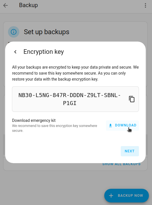

  1. To download the backup emergency kit, go to Settings > System > Backups.
  2. If it is your first time defining backup settings, select Setup automatic backup and download the backup emergency kit.
    • You can also download the encryption key again later from the backup configuration page.
    Screenshot showing the encryption key in the download dialog for the backup emergency kit
  3. Store the kit somewhere safe, outside the Home Assistant system.
